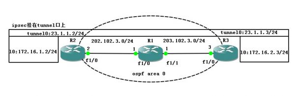

有没有牛人有思科路由器镜像版本15的实体机器。在模拟器中做ipsec over gre时遇到一个问题,求解答
我在gns 3 中按下面的配置是可以成功的,在web-iou中则不可以。现在不清楚是模拟器问题,还是版本问题。思科升级到15版本后命令变了还是不支持ipsec over gre 了。若能解决,非常感谢。
web-iou模拟器,镜像版本15.2:
R2#ping 172.16.2.3 so 172.16.1.2
Type escape sequence to abort.

不明白这个源地址怎么是tunnel口的地址,在gns3中,同样配置不是这样啊

我的配置文档如下:
R1
interface f1/0
ip address 202.102.3.1 255.255.255.0
no sh
interface f1/1
ip address 203.102.3.1 255.255.255.0
no sh
router ospf 10
network 202.102.3.0 0.0.0.255 area 0
network 203.102.3.0 0.0.0.255 area 0
R2
crypto isakmp policy 10
encr 3des
hash md5
authentication pre-share
crypto isakmp key cisco address 203.102.3.3
crypto ipsec transform-set myset esp-3des esp-md5-hmac
crypto map mymap 10 ipsec-isakmp
set peer 203.102.3.3
set transform-set myset
match address 110
interface Loopback0
ip address 172.16.1.2 255.255.255.0
ip nat inside
ip virtual-reassembly in
interface Tunnel0
ip address 23.1.1.2 255.255.255.0
tunnel source f1/0
tunnel destination 203.102.3.3
crypto map mymap
interface f1/0
ip address 202.102.3.2 255.255.255.0
no sh
router ospf 10
ip nat inside source list 1 interface f1/0 overload
ip route 0.0.0.0 0.0.0.0 202.102.3.1
ip route 172.16.2.0 255.255.255.0 Tunnel0
access-list 110 permit ip 172.16.1.0 0.0.0.255 172.16.2.0 0.0.0.255
R3
encr 3des
hash md5
crypto isakmp key 6 cisco address 202.102.3.2
set peer 202.102.3.2
match address 110
interface Loopback0
ip address 172.16.2.3 255.255.255.0
ip nat inside
interface Tunnel0
ip address 23.1.1.3 255.255.255.0
tunnel source f1/0
tunnel destination 202.102.3.2
crypto map mymap
interface f1/0
ip address 203.102.3.3 255.255.255.0
no sh
router ospf 10
ip nat source list 1 interface f1/0 overload
ip route 0.0.0.0 0.0.0.0 203.102.3.1
ip route 172.16.1.0 255.255.255.0 Tunnel0
access-list 110 permit ip 172.16.2.0 0.0.0.255 172.16.1.0 0.0.0.255

 楼主| 发表于 2013-3-21 14:57:49 | 显示全部楼层
图森破___Lee 发表于 2013-3-21 09:04
给个picture 啊!
不好意思啊,忘记放拓扑图了,现在放上去了,在最后
地板 2013-3-21 14:57:49 回复 收起回复
 楼主| 发表于 2013-3-22 11:33:50 | 显示全部楼层
问题相对解决了,在ios的版本15.2下(15.0和12的版本不能改),只要把对端ip写成tunnel的ip就好了,crypto isakmp key 6 cisco address 202.102.3.2
ip改成23.1.1.2就会通过了。应该是版本问题,在这个版本上的tunnel口上挂map时会提示:
% NOTE: crypto map is configured on tunnel interface.
        Currently only GDOI crypto map is supported on tunnel interface.
貌似是思科升级新版本后有了tunnel protection,所以对旧的配置方式不怎么重视了,命令上就有了问题。这是我的理解,不知道对不对,如果有高人了解思科这个版本到底做了哪些改进,请帮助一下像我这样的菜鸟。。。。。谢谢了
5# 2013-3-22 11:33:50 回复 收起回复
