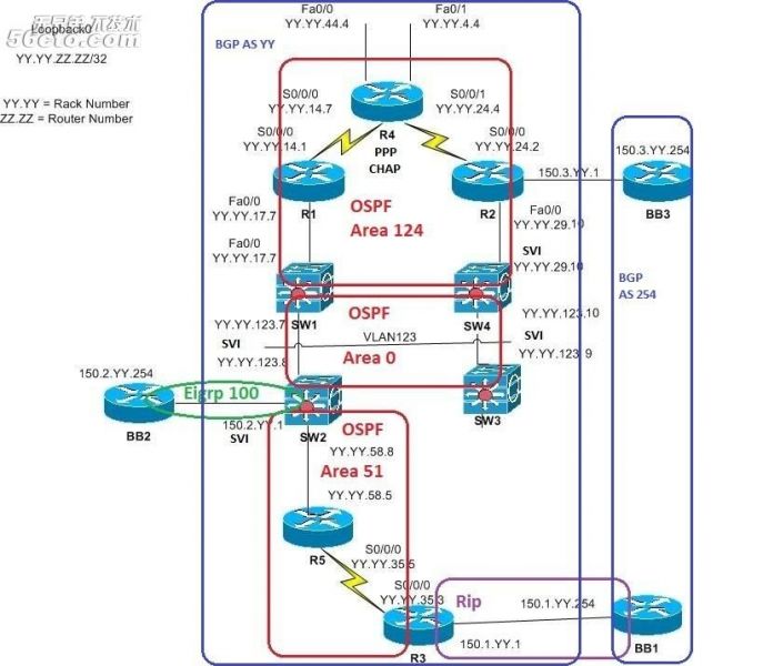

这个不是什么K3,国外叫4.1,而且你这个图也不是原版的,是别人自己画的!!!!!

那你又该图吗

我可以证实这个图是真的。请问你有题目吗?

需求如下:
4 t) O0 P. A* U! v' X+ J/ O% ]; C1 e! i  _3 j& w& b
5 Sections0 U) ~$ e0 n, M  i4 {7 B8 x
1. Layer2 Tech (approx 9 questions )
* X6 P7 M3 {! A/ D0 J% G2. Layer3 Tech (approx 10 Questions )
5 |' A1 c& k% m- A1 X6 D3. Multicast ( only 2 questions )" k* g) v) Y3 r
4. Advanced Services ( approx 9 questions )
! \1 K4 y0 i  k9 l2 |$ Y5. Optimize the network ( only 2 questions )2 y& w; s. H/ }7 K
1 x6 W4 |% ~" F* [
* s5 ^+ g# F0 |8 K/ M1 b: ?$ G3 m# I4 I5 f/ n+ T
# C1 Y  V3 M: l1 _. H+ s4 U- \, vSection 1: L2SPANNING-TREE:% s  i- y7 k3 I+ }. ]& m
+ k& r7 R. b5 q
3 r. @5 p  x' |, k, b1.1 Configure 2 spanning-tree domains.
; {7 \& t  }6 X+ cVLANs for backbones will be in instance 1 and, all other VLANs will be in
  V6 F) p7 q8 s: }/ |instance 2.
) r) x& U! q; P' |% }5 ~' rAny other VLAN will be in the default spanning-tree instance.
8 j& Q# Z' S$ F% t3 T" U. bSw1 must be the root for instance 1 with sw2 being the backup3 g, {2 L! Q- c  x" y4 j% b
Sw2 must be the root for instance 2 with sw1 being the backup.; \' A; i+ L$ X& T. d/ U6 z2 v
Ensure port fa0/20 is forwarding rather than blocking for MST 1 on7 K) E, h! d" J. ^5 Q+ n
switch 3. You must do this without any configuration on sW3 / SW4.
+ T5 @. j. ^3 X) L6 x
" K7 {1 r1 `/ F1.2 Configure Additional Spanning-Tree
" w) B) }0 f$ u$ [% d( @3 m3 wUse one command to enable portfast
5 ^2 M$ k/ q& l9 S/ O- U2 w* p8 YEnsure all access-ports go into err-disable if receiving any BPDU's. }  I' u* K  n- N
(This does not apply to BB router ports)& @- R8 |# U/ k2 ~7 H
Ensure backbone ports can't influence the STP topology ever
& Z0 u( Z9 ?6 `+ C/ mConfigure Spanning-tree timers such that if no bpdu's was received within xy seconds, that the network reconverges- b( @9 b# e  P6 ^7 M
0 {) F3 ?" C) i1 H/ n9 q; O
3 E) ^: r( B. n" j! ~% c1.3 CONFIGURE ETHERCHANNEL:
6 U# V3 A) ~0 GConfigure industry standard Etherchannel betwen SW1 & SW2
+ B$ y: a) A& ~- \4 Z0 x1 bConfigure proprietary Etherchanel between SW3 & SW41 ~/ Z, J. f$ G# J1 s
SW1 & SW3 should actively negotiate and SW4 & SW2 should only establish en Etherchannel when requested so
# r5 d9 z8 A4 g2 I! _
$ y* K0 @, ~: k; o1 O1 {
5 t6 L; f3 O" V( D1 I1.4 VLAN TRUNKING:4 Q% Q, I& V/ _( M
Configure all inter-switch links to use an industry standard, I( I/ n2 i0 u
Set the VTP Domain to "CCIERoutingAndSwitching": k8 ^5 O) g& N7 f7 {6 o: N; E
Uses VTP version 1. SW1 should be server, and rest Clients
( u# i, i: u( |( ]$ x' g# J- X9 E* Q+ Z- q$ }
1.5 RSPAN
$ K2 t$ k3 W. t9 a. HConfigure port mirroring for VLANS 17 and 59 on SW1 as the source. Traffic should8 q# b; z3 x0 K; Q2 x7 i1 m
be sent to SW2 fa0/9.
4 n( I& ^, W7 G" N5 ^4 w+ L3 v: _  g' I1 I( x- l+ r
" W: L% Q2 x: e
% g& X# ]7 v4 ]9 Q7 W$ y% b& f* p' \! ~5 a
! W+ B8 ?  n! Q; E2 H# n
3 o4 d( V+ ?# A. A% s7 s# x7 w
Section 2: IP Routing
  N5 z7 {+ V' I5 w8 @: q# I( N% d, _! k
2 i2 G2 p6 |+ L, Z9 G7 L2.1 Configure OSPF Area0, 142, 51% n1 n0 `) `- r$ Q2 d
Use the Rack # for the process ID.2 U/ P3 }. G) I4 B% z7 M
Configure the Router ID to match Loopback 0
# r8 E$ Q' \7 K) AConfigure Area 0 between on the Ethernet segment shared by all switches.0 G# P: ]: X  r- Y* n0 A
SW1 should control all routing, and SW2 should be the backup. (Use largest value)
$ |  Z' U' ]- M7 O
5 Y7 l% w( ^8 M  E& J; jConfigure OSPF AREA 142 between SW1-R1-R4-R2-SW4
- c; S; D5 |& I" l. q3 W+ iConfigure OSPF AREA 51 between SW2-R5-R3
7 A8 N$ b! m, I8 ~/ c
4 V8 o: D1 z1 r1 U, YConfigure Area 51 so that no type 7 LSAs are present.
  F5 U' A" b3 h2 t& ^# {* v$ L5 ?% S$ H6 |6 `3 }& w0 z1 `9 J
5 ?2 j' e# ]6 C2 N2 E. H: K
2.3 Configure EIGRP 100! Z9 a: y/ ]* o
Configure EIGRP 100 on SW2.
9 N* S* w, ~+ c, \. Q! k& sSW2 should not be queried for any routes.7 x5 ?% i. f# J' G) o2 W" R
. R7 }* W0 k$ k! m0 {Redistribute EIGRP 100 into OSPF. The EIGRP routes should not be present in/ @9 z& @4 g; J* U" h
OSPF Area 51. SW2 should generate a default route.# x+ D3 h1 K5 b; C5 n, i- h
! e; m: r: t& x' V! W
( L8 f! C% u. c2.4 Configure RIP
$ O0 L6 h. B- s& g0 ?2 UConfigure R3 with RIPv2
: W" d+ |7 r, i4 }0 t7 a2 q- P3 _2 a( S9 d
Redistribute RIP into OSPF. Only x.x5.0, x.x7.0, x.x.13.0, x.x.15.0/24 should be$ V! \/ B9 y; B4 K- r
redistributed. Use only line ACL for this task.
4 E- b: N/ j; S8 f, }$ O% f) t' x+ q* h; y- z/ z
Match the screen shot :3 K' W- f! M, G5 a
Screenshot indicated Routes x.x.5.0 & x.x.7.0 should appears as N1 routes , and the remainder should be N2 router.
2 T& a8 k- E7 q/ M( f8 m
4 r7 }- V) ?. {
0 d- ]6 z5 Z/ B7 C  K9 a6 I" ~9 a( o4 s/ ?
2.5 BGP
8 F( o. U- U. k; M, o5 dPeer R2 with BB3. Configure AS-Path so it shows as 254 108 104
, a  M4 @9 o; ^Peer R3 with BB1. Configure AS-Path so it shows as 254 109 103
- i7 P% @; H. u; {0 l/ i8 p2 [6 ?" o0 b5 X
Create full mesh peering between R4,R2,R1,R5,R3,SW2 using minimum commands
2 P4 i! B" ?) P- x6 f0 DOnly SW2 needs one iBGP Peering
$ m1 N) U+ t* J. y) \0 H2 Y, ?. h+ A2 `2 H
. A" k' j  x7 k  F6 Y5 H) R" X
- T0 W% @2 B5 z! N& v$ Z. W! |7 H***Variation--Some reports say that AS 254 253 must be overwritten to 254 108 107; P9 P' y( l4 c7 y3 [; @
***Variation--Some reports say that R2/R3 peer with BB1.* \6 Y* {3 I8 t2 F8 A
& I* `/ s! v# S/ ]3 ^$$$ mine was to configure the community such is reflects 254 108 104 $$$8 [5 \6 N( {& ]6 y- ?% W
$$$ mine was to configure the community such is reflects 254 109 103 $$$
5 K. E: y/ \" c: l+ a3 d
! _9 c' ]( _1 X, I/ e0 F) O7 M$ e" U***WARNING--Traffic Manipulation may be based on BGP Community.
/ l, F6 h2 T0 q5 x% Q; q3 T
& ?8 Q; S7 _% F2.6 IPV6 ? OSPF
! d. A) Y7 K! i+ ~# w$ pUse the Rack # for the process ID.
: x8 c/ M" ]' h/ j- V3 }Configure the Router ID to match Loopback 0
) n( P( @* Z7 j, W- i! TConfigure Area 0 between on the Ethernet segment shared by all switches.$ F/ ]! B9 S. `1 f: t- p
+ k/ `' Q+ g1 m7 M2 W# C! D. h% \( V) x! L3 b$ n* q4 ^
) ]% V; O: A5 E% J% e! gConfigure OSPF AREA 51 between SW2-R5-R3; U% t. W% L  U4 `* A
Configure the most secure form of authentication for IPv6) ^1 c* X! R1 q% O+ g
& ~5 \. M# \0 P3 C$ c
2.7 IPv6 Filtering
7 }  w3 R8 v5 s8 M1 B4 }Add a Loopback100 to SW2, give it Global IPv6 Address and redistribute into OSPFv3
1 q* D. N( ?) a# i& B* FConfigure OSPF filtering to allow SW2 Loopback 100 in Area 0 to go into Area 142, but not Area 51.
3 t# q8 F" F3 p
; n; L3 ]3 i/ y*** Variation **
9 H5 d7 |  O5 C: |. a$ ]; v8 \Configure OSPF filtering to allow SW2 Loopback 100 in Area 0 to go into Area 51, but not Area 142.  A; u2 R: T' z" N+ J
  R# e) b( d8 F* S8 {( u) N0 i2 w( f8 d. Z
Section 3 Multicast:
* T1 n& e- j/ Y3.1 IPV4 MULTICAST( ~8 E& o# j. U2 t
Enable PIM-SM R1,R2,R4,SW1 - SW4. Use a non-cisco proprietary based method to send RP
3 X+ y6 @4 ?& [3 x" ]6 D# y& i; ~information. Configure R1 and R2 Loopbacks to act as RPs both RPs, with R1 as the preferred RP.
* a, I9 B* T7 W  o. X" w
5 M, A, g9 W! o; O6 T+ B7 I3.2 Configure R4 Lo0 to join 225.1.1.1 (Source) and ping from SW2 SW2 receiver --- i remember slightly different....might be starting to forget this.- c( ?, r' O8 Z: l2 J" d
** You need to ping from R4 the multicast group 225.1.1.1. The interface towards BB2 will be joining the multicast group 225.1.1.1. Ensure that you resolve any SPF issues if needed.( h, q8 T& @+ |/ }# C: B4 ^) k0 s
2 P: f1 z, w2 G+ m4 C) G- I2 h5 dSection 4 Advanced Services:
% i; R) g, k7 H+ i, r* Q' I9 ~4 C' W4 R4.1 OER/PFR
1 q. m( ~$ H- L4 LYou are required to implement OER on the network. R4 will be the master controller and R1 & R2 will be the Border routers.Use a key of "CISCO". Ensure that the OER sessions is established from the Loopback interfaces.
; Z4 e  `" G5 v3 P+ a$ [% O2 R- M3 `( c) @% k
4.2 OER Optimization. X/ w! T' X* l, k# K; A
3 {# A: v  G, E" A, \, D8 j9 d
You need to optimize the OER implementation such that when packets with a DSCP of 41 passes the network, it is routed out to R1 exit interface, and when a DSCP of 31 passes, it is routed out to R2 exit interface.
$ a" G: g- B& X* N# R0 d4 \. @You are allowed to create 1 prefix-list for NET yy.yy.100.0/24 should the solution require this. (might be missing a word or 2 further more)
5 t( N0 A0 O  Y& P1 `
- Y  s$ Q4 j; @# S4.3 NETFLOW
9 C0 h& s0 K+ |: C3 j$ ?Configure Netflow on R5 for IPV6 netflow (on track - can't remember exact specifics at this stage )
' D6 T+ q) F7 n0 W' a" [/ l' QSend to 100.100.100.1009 ]" z, p* a+ x# R
aggregate flow cache
0 J* B) U6 [6 T5 V' v8 n
! u  b1 G# T+ t# k6 O4.4 QoS - LAN (6 PTR)
7 r( L. ~$ m  ?2 M6 b: {3560 assign COS1 for all untagged traffic.' Z$ P  x; _" x) W! r5 h
On SW1 fa0/15, assign Queue1 for COS1 and Queue 2 for COS5.& S( ?. f8 M" M& l) K
Queue 1 drop threshold were to be set. ( question is right on track - can't remember exact wording as well )2 v( w& H7 [9 @7 X
) u  t, Y, L- D/ `2 }$ b& P$ N4.5 QOS - CBWFQ8 K' G1 t# n$ }- a* {' x7 D
The IT administrator requires that you implement QOS for Voice that is soon to come onto the network. (i sorta remember that the voice waas implemented between R5 and R3......(missing some info here)! t- O1 S8 T6 O- j3 |; w
# T$ l3 d* L# [
4.6 WCCP6 f* D! t  \: G0 I
5 S) v# }! t  [" h# m& o  PThe IT department is wanting to implement a web-caching solution. This should be implemented on R2.(can't remember correct device to implement on). Your task is to use service number 61 & 62. There is 3 interfaces taking part in this. Traffic from a certain port is not allowed to have any wccp configuration on it.......(missing some further info): D8 N8 c) j/ s& b. B
$ l' S6 l8 f8 G+ r
  `% |. s$ R* F2 |5 e# U' a4.7 NAT+ `0 Z. t4 \; E1 m7 D
You are required to implement NAT. You need to match the output in the screenshots provided./ \/ `6 C5 t( A  G
: v" }  N5 I/ y( }+ q4 F1 w
Screenshot :- z; A8 @" f' I( p7 M5 x
screenshot 1 indicates NAT is to be implemented on R4, with nat translations showing SW1 is pinging SW4
& m2 a. y2 j8 q. b* U5 oscreenshot 2 indicates SW1 pinging SW4 with a new source not yet created on the SW.Thus create new loopback and ping SW4 with ip yy.yy.200.4
5 A. m1 F6 R, B, P/ r; m6 b) `4 y+ uScreenshot 3 indicates SW4 pinging SW1 with a new source also as per above, but pinging SW1 with ip yy.yy.100.1' X0 f# Y; P& j0 t$ t6 Q$ ~7 y6 s, T
! j  m4 A- r' P1 L& o
Notes: you are allowed to add 1 static route on a maximum of 4 devices.3 l  |8 a4 d+ l7 Q/ ~: X" q
1 V+ K  f* M) G7 S! v; {3 M
4.8 DHCP (Rough Guess)
: g2 C( r, k8 @5 ^4 x  gThe junior network administrator has started implementing a DHCP server on R4.Your task is to complete the DHCP configuration. At some point in the future, a printer will be added with mac address 1234.1234.1234. Ensure that the printer always get the ip yy.yy.100.45
  A" w& f( K) Z, O5 I2 G
( y5 m7 I% T& ~) L4.9 DHCP Security, DAI (Rough Guess)
5 F8 Y: Z$ \( l9 `! JThe IT department is worried about DHCP security and invalid arp /spoofed packets. You are required to implement a dynamic solution that will counter against any invalid spoofed dhcp requests and arp packets; `6 j: A" k) Q6 Z! O. t8 J. c
! c% N& J; i4 B3 L
4.9 NTP" M/ K( @1 t3 k' q8 C# h

. h, u0 ]* L5 ~# ]0 f1 @5 }  R7 k) w
: j$ K, T5 \7 [4 L0 ASection 5. Optimize the Network% Z( I: e: l" y2 y
* f' y2 Q: p( I5 B9 d6 c- z' {3 j
5.1 Implement SNMP& u- [5 b/ T" P2 C1 E3 @5 F
Implement SNMP to an NMS system. Use the community string of CiscoWorks- x4 b# H4 P0 D
The NMS system is located at yy.yy.44.100, and requires the bgp trap to! j% F' u3 f3 Y" d8 ]7 j! x" m
be sent.+ Z4 ]% q, J- E' V2 c2 r
5 E& z2 B( v, e# f5.2 Configure an EEM applet name ?conf_change? (without the quotes)( p% H; {) G. j
The EEM applet needs to write the date and time to a file saved in flash.- u; B" ^, h" J. w7 A
The EEM applet needs to activate every time someone makes changes to the, E# [4 b9 i/ ?; R2 i* R( @  c5 @" M
running config. Also, a syslog message has to be generated with the string ' R8 c+ ^  B4 {7 ?; J6 d
3 N- a5 r% c; M3 Q0 w不知道是真是假,不能确定。最好找有培训的人对比一下。
