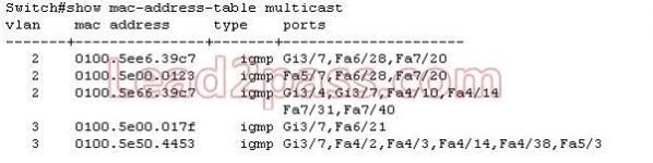

QUESTION 175
Refer to the exhibit. From the MAC addresses shown in the command output, to which two ports is the multicast stream 225.230.57.199 being forwarded on this
switch? (Choose two.)
A. Fa6/28
B. Fa7/20
C. Gi3/7
D. Fa4/2
E. Fa4/14
F. Fa4/38
G. Fa6/2
谁能解释一下啊,谢谢!
答案:CE

发表于 2014-4-7 23:48:33 | 显示全部楼层
你要学习一下如何把IP multicast address converted to Mac multicast address/

发表于 2014-4-16 12:41:02 | 显示全部楼层
多播IP地址与MAC地址对应关系
多播MAC地址前25为固定,后23为用IP地址的后23位填充
225.230.57.199的二进制位
11100001.11100110.00111001.11000111
填充后
0000|0001-0000|0000-0101|1110-0110|0110-0011|1001-1100|0111
写成16进制后
01-00-5E-66-39-C7
对应的口是G3/7 F4/14
