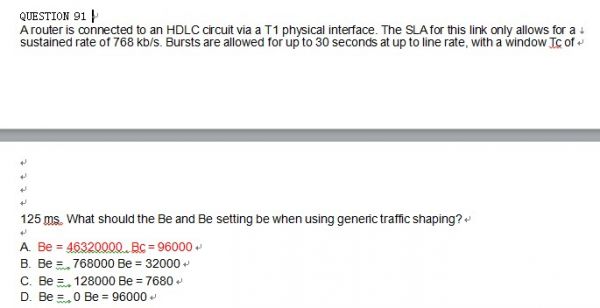

发表于 2014-3-19 22:36:11 | 显示全部楼层 |阅读模式
请指教

QOS里面的管制,令牌桶算法,看书吧

Bc=CIR*Tc/8/1000Be=(AR-CIR)*Tc/8/1000
3 l: J& n& I) l! K) u' B5 c  R7 @" [Bc=768*125=960009 M2 t& C* O; S9 r+ n! H% s) _" o
題目要求 Bursts are allowed for up to 30 seconds at up to line rate, $ u$ K( t1 ~4 W
T1=1544000bps
, K. ^7 m9 Z& k" H. d0 ]+ m0 r& CBe= 1544000bps * 30 = 46320000 bits.
