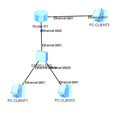

拓扑
拓扑
如图,左侧是一个最基本的单臂路由实验
PC1处于VLAN10,网关192.168.10.1,手动配置IP地址,可以PING通VLAN10和VLAN20的网关
PC2处于VLAN20,网关192.168.20.1,无法自动获取IP地址!!!(这是遇到的问题)
发现问题以后,我又添加了一个PC3,想试试R1的DHCP功能是否正常,结果可以获得IP地址,DHCP是正常的
用wireshark抓R1  E0/0/0口的数据包,发现路由器R1能收到DHCP DISCOVER包,但却没有回应
这是ENSP软件的BUG吗?单臂路由可以单独实现,DHCP也可以单独实现,但是两者结合到一块儿就不适用了
路由器的配置文件
<router>di cu
sysname router
dhcp enable
ip pool vlan20
gateway-list 192.168.20.1
network 192.168.20.0 mask 255.255.255.0
excluded-ip-address 192.168.20.2 192.168.20.3
dns-list 8.8.8.8
ip pool vlan2
gateway-list 192.168.2.1
network 192.168.2.0 mask 255.255.255.0
dns-list 7.7.7.7
aaa
authentication-scheme default
authorization-scheme default
accounting-scheme default
domain default
domain default_admin
local-user admin password cipher OOCM4m($F4ajUn1vMEIBNUw#
local-user admin service-type http
firewall zone Local
priority 16
interface Ethernet0/0/0
dhcp select global
interface Ethernet0/0/0.10
vlan-type dot1q 10
ip address 192.168.10.1 255.255.255.0
interface Ethernet0/0/0.20
vlan-type dot1q 20
ip address 192.168.20.1 255.255.255.0
dhcp select global
interface Ethernet0/0/1
ip address 192.168.2.1 255.255.255.0
dhcp select global
interface Serial0/0/0
link-protocol ppp
interface Serial0/0/1
link-protocol ppp
interface Serial0/0/2
link-protocol ppp
interface Serial0/0/3
link-protocol ppp
interface GigabitEthernet0/0/0
interface GigabitEthernet0/0/1
interface GigabitEthernet0/0/2
interface GigabitEthernet0/0/3
wlan
interface NULL0
user-interface con 0
user-interface vty 0 4
user-interface vty 16 20
return
<router>
交换机的配置文件
<sw>di cu
sysname sw
vlan batch 10 20
cluster enable
ntdp enable
ndp enable
drop illegal-mac alarm
dhcp enable
diffserv domain default
drop-profile default
aaa
domain default
local-user admin password simple admin
interface Vlanif1
interface Vlanif20
dhcp select relay
dhcp relay server-ip 192.168.20.1
interface MEth0/0/1
port link-type trunk
port trunk allow-pass vlan 2 to 4094
interface Ethernet0/0/2
interface Ethernet0/0/3
interface Ethernet0/0/4
interface Ethernet0/0/5
interface Ethernet0/0/6
interface Ethernet0/0/7
interface Ethernet0/0/8
interface Ethernet0/0/9
interface Ethernet0/0/10
port link-type access
port default vlan 10
interface Ethernet0/0/11
interface Ethernet0/0/12
interface Ethernet0/0/13
interface Ethernet0/0/14
interface Ethernet0/0/15
interface Ethernet0/0/16
interface Ethernet0/0/17
interface Ethernet0/0/18
interface Ethernet0/0/19
interface Ethernet0/0/20
port default vlan 20
interface Ethernet0/0/21
interface Ethernet0/0/22
interface NULL0
return
<sw>

发表于 2014-8-13 20:54:06 | 显示全部楼层
把交换的trunk口改为Hybrid方式并且标记需要通过的VLAN,属于VLAN 20的端口也不要使用ACCESS方式使用华为默认的Hybrid非标记模式,在看看还有没有什么问题。还有既然是单臂路由,那么交换机和路由器的子接口属于一个二层范围,不需要再交换的VLAN 20下启用DHCP 中继。
