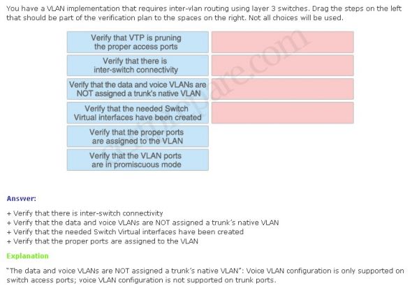

①        其中第6题把右边框框上的V1,V2,V4改成了SNMP version 1、SNMP version 2、SNMP version 3.答案不变。, a6 `. u( Z' L+ y; T" ]# A

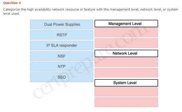

②        11题,右边的三种类型顺序变了下,如下所示:; o7 w: b2 m  a
拖图2.jpg ( L% n0 a1 J8 x2 ~7 q. a

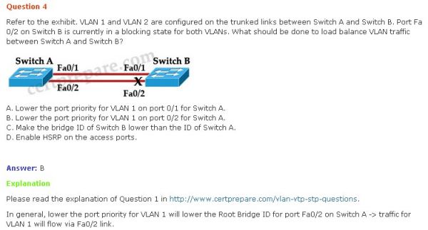

* U) u9 C" u- J5 m$ p再来说说选择题。感觉翻那么三四次就遇到一个新题,吓尿了。幸亏运气好啊。刚去网上搜了搜,搜到几道:6 u: g3 |- y1 y( Z
新1.jpg 8 N$ ?' v' s! H$ |5 X! r( e; ~5 l
这个没啥说的. v% H/ T, T' B" l% B4 {
5 ~$ b  W  I( z% U; S5 r: s6 j0 o这个貌似之前的战报见过,记住就行了。

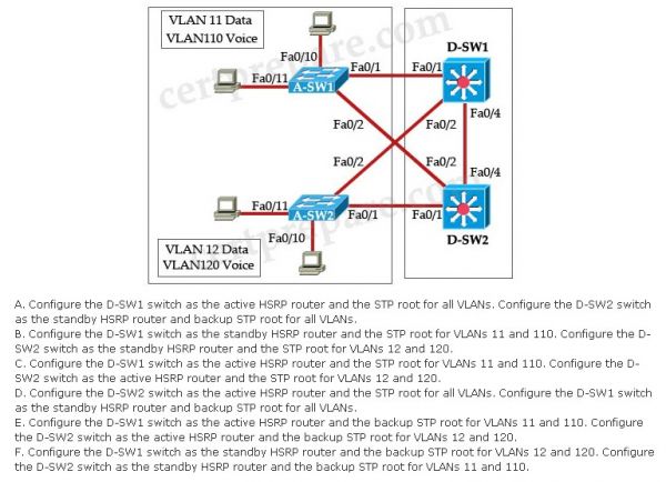

, Q; x! A5 h% l* i③   题干是这个:Refer to the exhibit. On the basis of the information provided in the exhibit, which two sets of procedures are best practices for Layer 2 and 3 failover alignment? (Choose two)- K$ f' w; I6 h
% A# ~# ]- {' Z0 p% L我选的C和F。) O' z9 N: t* J, Y# N8 u: {) \

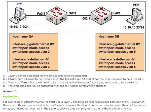

④        Study the exhibit carefully. Both host stations are part of the same subnet but are in different VLANs. On the basis of the information presented in the exhibit, which statement is true about an attempt to ping from host to host?
7 ?& p6 L2 `# w% m/ A 新4.jpg , [6 w7 f' R& X( Y
他这答案写着D。。。但是我昨天选的A,满分了。。。大家商量下吧。。。
