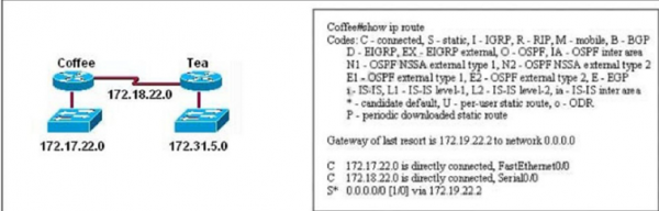

* R7 i+ T/ U) v& e( a* C* b8.QUESTION 533
Users on the 172.17.22.0 network cannot reach the server located on the172.31.5.0 network.The network administrator connected to console port, issuedthe show ip route command,and was able to ping the server. Based on the outputof the show ip route command topology shown in the graphic,what is the cause ofthe failure?7 X) y6 L+ I, y- u# O% }
捕获.PNG , N/ l8 c5 \( M8 f
A. IP routing is not enabledB. A static route is configured incorrectlyC. The network has not fully convergedD. The FastEthernet interface on Coffee is disabledE. The routing table on Coffee has not updatedF. The neighborrelationship table is not correctly updated 题库选D, 我认为这题题干有问题。依据所给的图,Coffee是不可能ping通server的。反正D选项肯定也不对,如果Coffee的FastEthernet interface disabled的话,路由表中不会出现C 172.17.22.0 is directly connected这一条。所以这题非要选的话我选B,我只能意淫也许题干想说was unable to ping the server,把unable错打成able了

向楼主学习。个人觉得第3题选show arp没有错,虽然在PT里可以简写,但是看题目选项,应该是以完整形式出现,比如说show running-config ,要是出现sh r在PT也能运行,但不可能出现在考试选项中。
( j5 T! `5 W2 Z" ^第4题要是有3选项,就是BCD,反正The switch will originate VTP summary advertisements没有错。7 ~) h8 J4 m5 Y, t2 X/ ]
其他没有问题
0 T0 {# N# y7 {9 i学习楼主这种钻研的精神!
