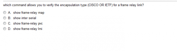

这题选什么?

发表于 2012-8-22 19:46:28 | 显示全部楼层
选B ?
发表于 2012-8-22 20:30:21 | 显示全部楼层
选A
发表于 2012-8-22 21:33:57 | 显示全部楼层
A,楼主可以做实验 看看
发表于 2012-8-22 22:52:48 | 显示全部楼层
A
发表于 2012-8-22 23:07:34 | 显示全部楼层
选B才对,这题叫看的是encapsulation,是封装,只有查看接口能看到封装
A是查看帧中继映射的,就是看哪个IP对哪个DLCI,根本没关系

发表于 2012-8-24 21:14:37 | 显示全部楼层
A
这题要求你,哪个命令能确认(Frame-relay 的encapsulation的 CISCO OR IETF)
当local和remote 都是cisco 机器的可以用CISCO, 当remote的router不是cisoc的时候,需要用IETF。
show interface serial 只能确认物理interface的encapsulation.
下面是例子
R2#sh frame-relay map
Serial0.45 (up): ip 160.1.245.4 dlci 24(0x18,0x480), static,
              broadcast,
              CISCO, status defined, active
Serial0.45 (up): ip 160.1.245.5 dlci 25(0x19,0x490), static,
              broadcast,
Serial0.6 (up): point-to-point dlci, dlci 26(0x1A,0x4A0), broadcast
Router>show interfaces serial0/0
Serial0/0 is up, line protocol is up
Hardware is PowerQUICC Serial
  Description: Testing - Frame Relay link
  Internet address is 172.27.177.2/25
  MTU 1500 bytes, BW 1544 Kbit, DLY 20000 usec,
     reliability 255/255, txload 1/255, rxload 1/255
  Encapsulation FRAME-RELAY, loopback not set
  Keepalive set (10 sec)
  LMI enq sent  41, LMI stat recvd 41, LMI upd recvd 0, DTE LMI up
  LMI enq recvd 0, LMI stat sent  0, LMI upd sent  0
  LMI DLCI 1023  LMI type is CISCO  frame relay DTE
  Broadcast queue 0/64, broadcasts sent/dropped 1/0, interface broadcasts 0
  Last input 00:00:01, output 00:00:09, output hang never
  Last clearing of "show interface" counters 00:06:59
  Input queue: 0/75/1/0 (size/max/drops/flushes); Total output drops: 0
  Queueing strategy: weighted fair
  Output queue: 0/1000/64/0 (size/max total/threshold/drops)
     Conversations  0/1/256 (active/max active/max total)
     Reserved Conversations 0/0 (allocated/max allocated)
     Available Bandwidth 1158 kilobits/sec
  5 minute input rate 0 bits/sec, 0 packets/sec
  5 minute output rate 0 bits/sec, 0 packets/sec
