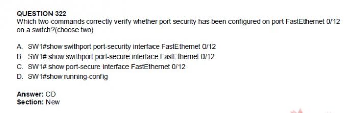

此题少了一个选项,完整的题目为:8 s/ W( c8 X7 o- B, N
Which two commands correctly verify whether port security has been configured on port FastEthernet 0/12 on a switch?(choose two)
A. SW1#show swithport port-security interface FastEthernet 0/12
B. SW1#show swithport port-secure interface FastEthernet 0/12
C. SW1#show port-secure interface FastEthernet 0/12
D. SW1#show running-config
E. SW1#show port-security interface FastEthernet 0/12
正确答案:DE
% u* M8 M9 G. ^& O# f! b-------------------------------------------------------------------------------------3 Q1 y/ K) @1 D# F

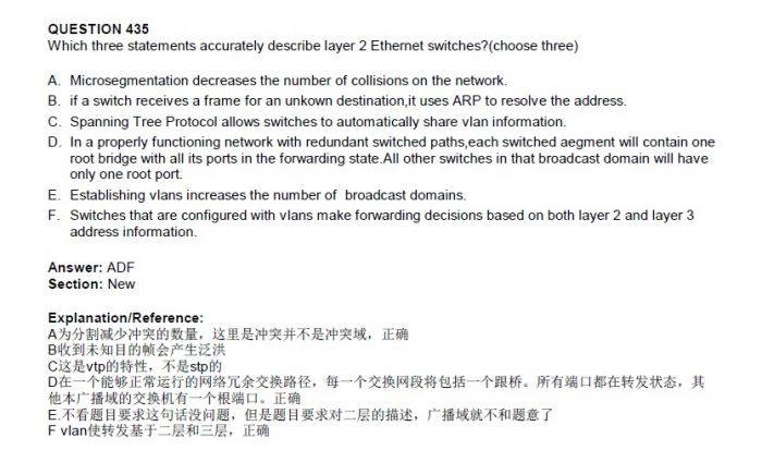

435题正确答案为:ADE+ n7 m0 Y1 |! @, Z( p: N* p
