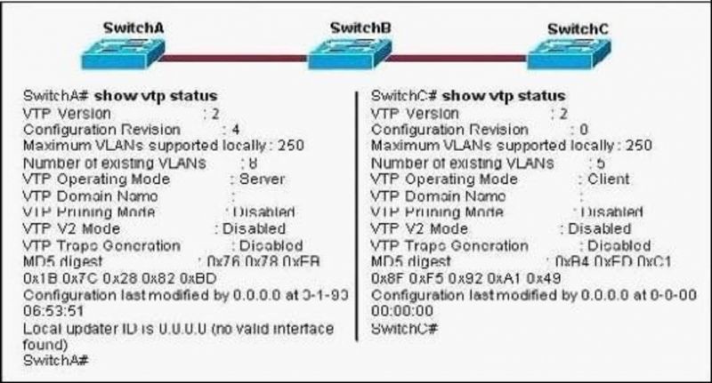

QUESTION 177 (牛头不对马嘴)Refer to the exhibit. Which of these statements correctly describes the state of the switch once the bootprocess has been completed?3 [. d4 @9 @5 s0 T7 }) d' W# w. P
9 v3 x% p  e) J3 B% Q' l5 k  m. ?  X. F* U. j8 o
A. Only the default VLANs are configured on SwitchA.# ?; @2 E" r+ R2 W
B. SwitchA does not have a VTP domain name configured.# D% k4 ?, `1 P2 q$ a$ B& R3 q* Z
C. VTP pruning needs to be enabled on SwitchA.1 ?! Q/ w( ?+ m
D. SwitchC needs to have the VTP domain name configured.
2 a+ V) x4 D# o  M) c- pE. SwitchB is in transparent mode.
% e( n  r$ j/ j% ~: B) vAnswer: B* }3 h& b, ~8 v* T
(牛头不对马嘴)正确的是:Refer to the exhibit. The three Catalyst 2950 switches have been configured for VTP.Trunking is properly configured and operational on all three switches.The show vlan command issued on Switches C displays only the default VLANs.Based on the output from the show vtp status commands shown in the exhibit,why is this true?

  k& `6 B5 c  }# T1 U- ~- u" ~Q177:配置vtp的话,需要两个参数,一个是vtp mode,一个是vtp domain name,缺少domain name,不会转发vlan信息
